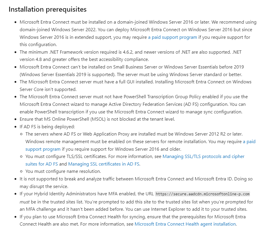

    Based on the error message it could be issue with the .NET Framework. can you please check the versions of .NET the minimum .NET Framework version required is 4.6.2, and newer versions of .NET are also supported. .NET version 4.8 and greater offers the best accessibility compliance.
    Also, please follow and verify the Prerequisites for Microsoft Entra Connect
    Hope this helps. Do let us know if you any further queries by responding in the comments section.
