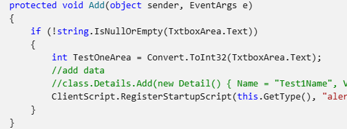

    protected void Add(object sender, EventArgs e)
        if (!string.IsNullOrEmpty(TxtboxArea.Text))
            int TestOneArea = Convert.ToInt32(TxtboxArea.Text);
            //add data
            //class.Details.Add(new Detail() { Name = "Test1Name", Value = TestOneArea});
            ClientScript.RegisterStartupScript(this.GetType(), "alert", "alert('Class is saved');", true);
