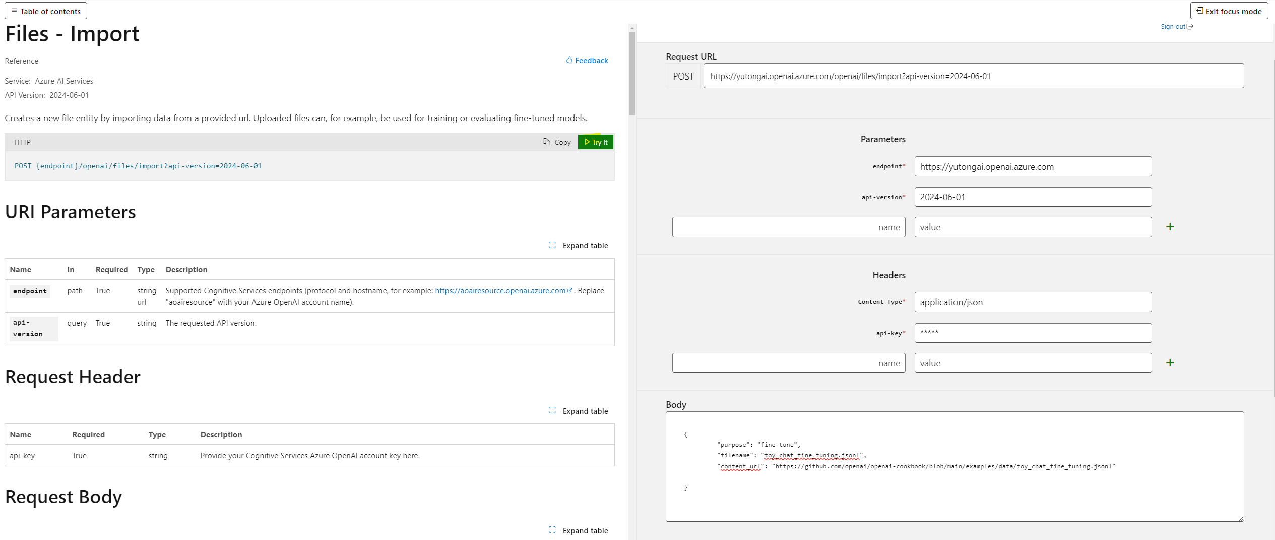

    I am sharing my working request body here -
    	 "purpose": "fine-tune",
          "filename": "toy_chat_fine_tuning.jsonl",
          "content_url": "https://github.com/openai/openai-cookbook/blob/main/examples/data/toy_chat_fine_tuning.jsonl"
    My header -
    apim-request-id: **
    content-type: application/json; charset=utf-8
    location: https://yutongai.openai.azure.com/openai/files/file-*****?api-version=2024-06-01
    You can use the try it button to check on your input very quick - https://learn.microsoft.com/en-us/rest/api/azureopenai/files/import?view=rest-azureopenai-2024-06-01&tabs=HTTP

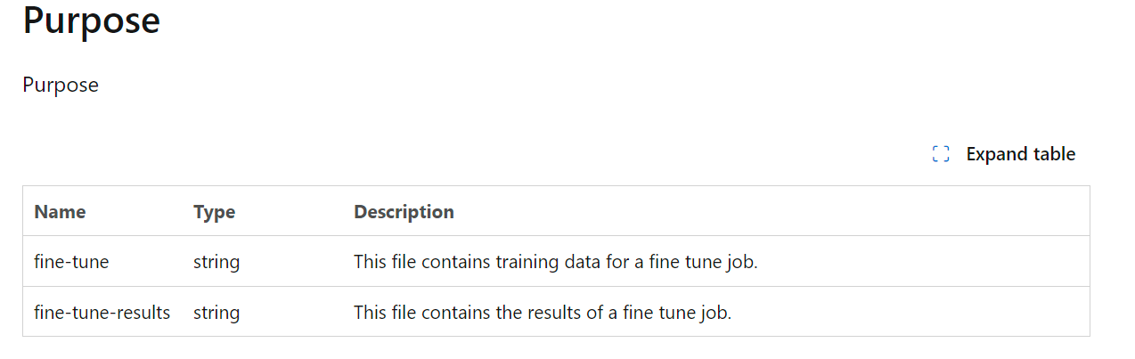

    Then, the role is only working for fine-tune and fine-tune-result as below -

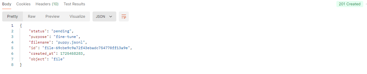

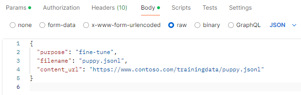

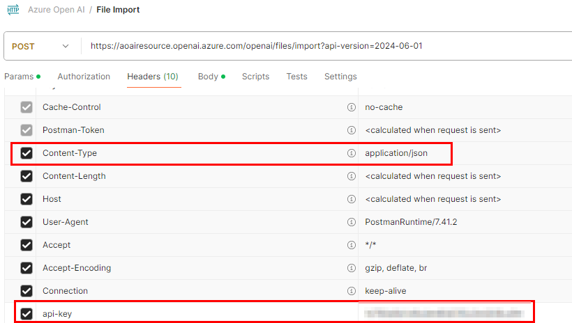

    Hi @Muso, Marin Greetings! Apologies for the delayed response on this, I have tested the end point with a sample request and can confirm that it is working.
    I noticed from your posting that you are passing the parameter Ocp-Apim-Subscription-Key as a header. Referring to the API document on Azure Open AI Files import, the end point expects the api-key parameter in the header which is the Cognitive Services Azure OpenAI account key.
    I also notice that you have set the Content-Type to application/url in the above request. I have set it to default application/json. Please refer the below images of the API call for your reference.
    Here is the request body
    Response from the API
    Hope this helps! Please let us know if you have any additional questions or need further assistance on this.
