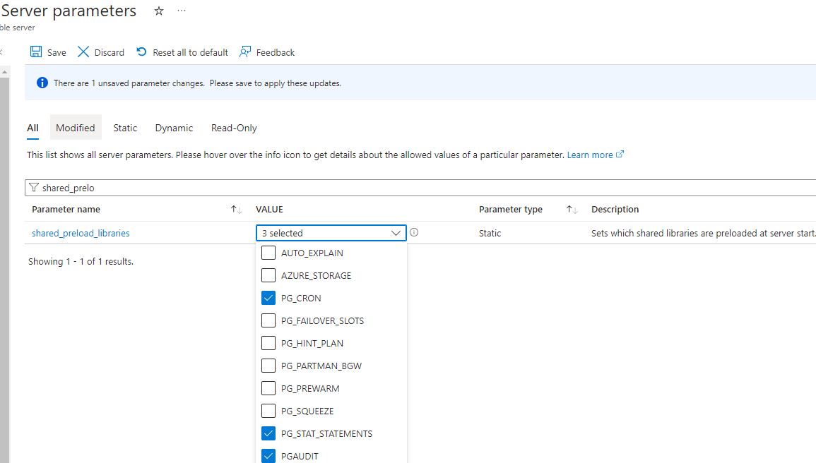

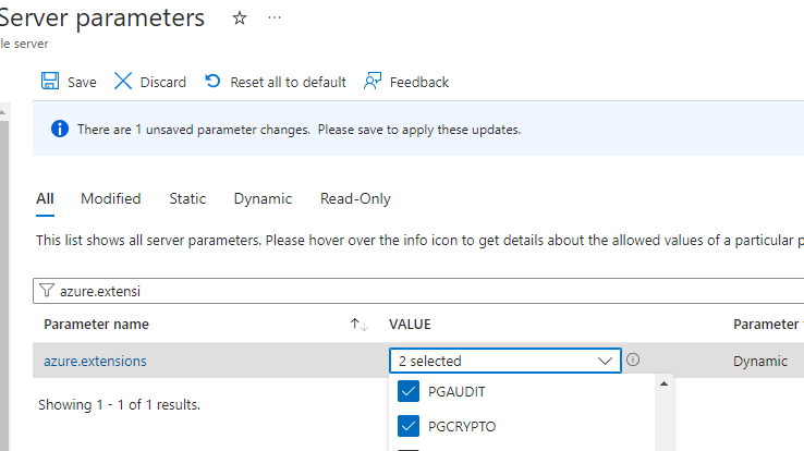

We have Azure Database for PostgreSQL flexible server
I would like to add over AZURE portal pgaudit extension.
First of all I add here:
Then I try to add here:
Bu t I get deployment error like this : The resource write operation failed to complete successfully, because it reached terminal provisioning state 'Failed'. Click here for details
{"code":"DeploymentFailed","target":"/subscriptions/b4f87ebc-29ee-4ea9-9bde-da59d13b1731/resourceGroups/microservices_group/providers/Microsoft.Resources/deployments/PostgreSQLFlexibleServerParameters_c871b50d51f34bf199630fd76aecf","message":"At least one resource deployment operation failed. Please list deployment operations for details. Please see https://aka.ms/arm-deployment-operations for usage details.","details":[{"code":"ResourceDeploymentFailure","target":"/subscriptions/b4f87ebc-29ee-4ea9-9bde-da59d13b1731/resourceGroups/microservices_group/providers/Microsoft.Resources/deployments/serverParameters-0-c871b50d51f34bf199630fd76aecf3f8","message":"The resource write operation failed to complete successfully, because it reached terminal provisioning state 'Failed'."}]}
The resource write operation failed to complete successfully, because it reached terminal provisioning state 'Failed'. (Code: ResourceDeploymentFailure, Target: /subscriptions/b4f87ebc-29ee-4ea9-9bde-da59d13b1731/resourceGroups/microservices_group/providers/Microsoft.Resources/deployments/serverParameters-0-c871b50d51f34bf199630fd76aecf3f8)
The resource write operation failed to complete successfully, because it reached terminal provisioning state 'Failed'. (Code: ResourceDeploymentFailure)
The value 'pg_availability,pg_cron,pg_stat_statements,pgaudit' for configuration 'shared_preload_libraries' is not valid. The allowed values are 'the ones indicated by PostgreSQL documentation'. (Code: InvalidConfigurationValue)

  1. bill.chung 0 Reputation points
    2024-09-06T08:14:11.8+00:00
    I encountered the same issue. My solution was to use AZ CLI to update shared_preload_libraries. The value pg_availability in the error message needs to be removed. The specific problem is that when modifying the shared_preload_libraries parameter through Azure’s web interface, it automatically adds the disallowed value pg_availability. The web interface caused this issue.
    az postgres flexible-server parameter set --resource-group <resource_group> --server-name <server_name> --name shared_preload_libraries --value pg_cron,pg_stat_statements,pgaudit
    az postgres flexible-server restart --resource-group<resource_group> --name <name>
