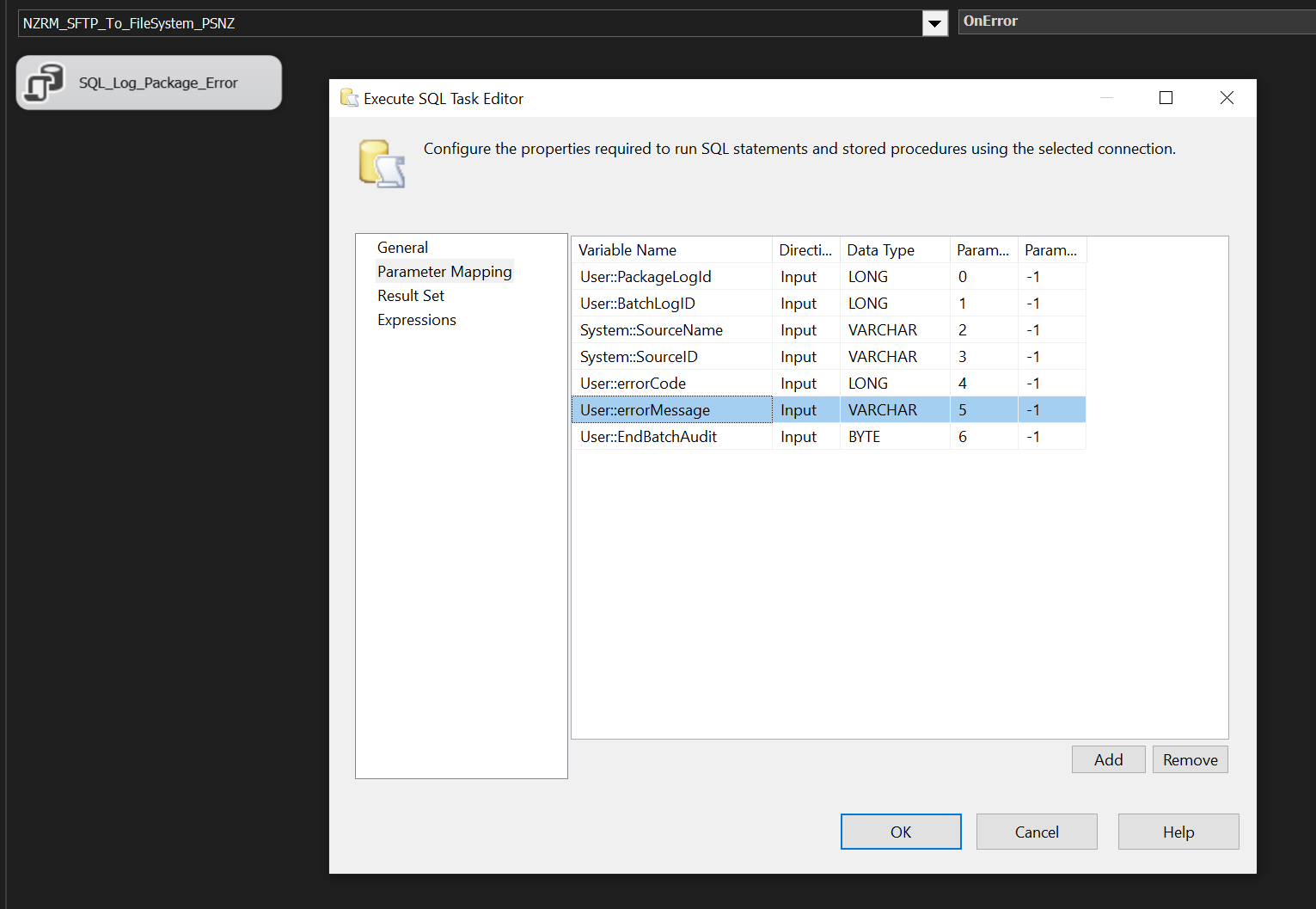

I have an SSIS package that calls a script task to access an SFTP server. The call to that script task includes 2 ReadWrite variables, errorCode and errorMessage. If the Catch block is entered, the error message and error code are set from the exception details and the task return is set to Failure.

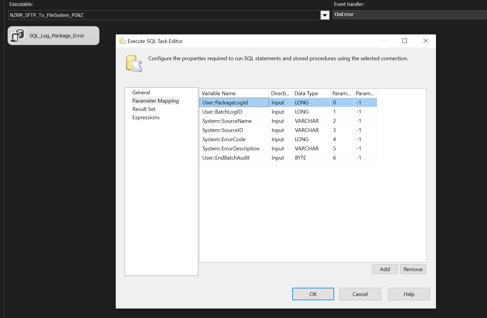

On return to the package, execution enters an OnError Event Handler which has a single task which is Execute SQL. That calls a stored procedure to log the issue passing 7 variables.

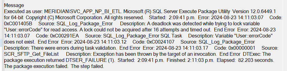

Currently the Error Code and Error Description passed in are System variables. As the details returned from the script task are in User variables, I changed the Parameter Mapping to the errorCode and errorMessage. When the SFTP call failed, the Event Handler also fails saying that after 16 attempts, it had failed to lock the errorCode variable for Read as the variable was not found.
I don't understand how that's possible as there are other user variables passed in to the same stored procedure that don't cause the problem and when I'm editing the SQL Task, the errorCode and errorMessage variables can be picked.
