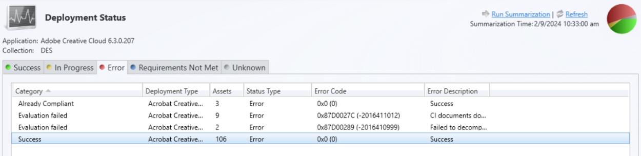

I’m facing a confusing issue with software deployment in SCCM. I deployed software as "Required" via SCCM, and while some client PCs successfully installed the application, the deployment status in the SCCM console shows an error.
Here’s a summary of the issue:
  • The software installs successfully on the client PCs.
  • In the SCCM console, these successful installations are showing as "Error" under the status type.
  • In the reports, the error code is 0x0 (0), which usually indicates success, and the error description also says "Success."
I’ve attached a screenshot of the deployment status report for reference:
I would like to understand why this discrepancy occurs. Could it be related to the packaging of the software, or is there another issue that might be causing this mismatch between the console and the reporting?

    It should eventually update when the next summarisation runs and the clients have sent the state messages again.

    Detection rules. That snippet just shows that the installer exited with code 0 which is success. However, look further/elsewhere in the logs to see if the app was successfully detected. Take a look at AppDiscovery.log on the client to verify this.
    Similar thread for your reference: Application Evaluation Error (Success)

    I just spotted this on the latest hotfix for 2503, KB32851084, looks like it resolves the issue: "Deployment status reporting and summarization are updated to more accurately reflect the correct count of success or error conditions."
    We're having this issue, since we upgraded from 2409 to 2503.
