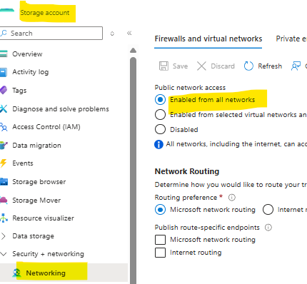

  2. Sumarigo-MSFT 47,466 Reputation points Microsoft Employee Moderator
    2024-09-16T05:49:30.46+00:00
    @Yash Firstly, Apologies for the delay response!
    Plan 1:
    You should provide access to his user account. Have them grant the below roles on the Azure Storage account level:
     Storage Table Data Contributor: Use to grant read/write/delete permissions to Table storage resources.
    • Contributor: Grants full access to manage all resources, but does not allow you to assign roles in Azure RBAC, manage assignments in Azure Blueprints, or share image galleries.
    • Plan 2: Also ensure that they don't have any Networking --> Firewall, VNET and Private Endpoint enabled.  WIthin the Azure Storage Account --> Networking --> Enabled All Network
    Please let us know if you have any further queries. I’m happy to assist you further.
