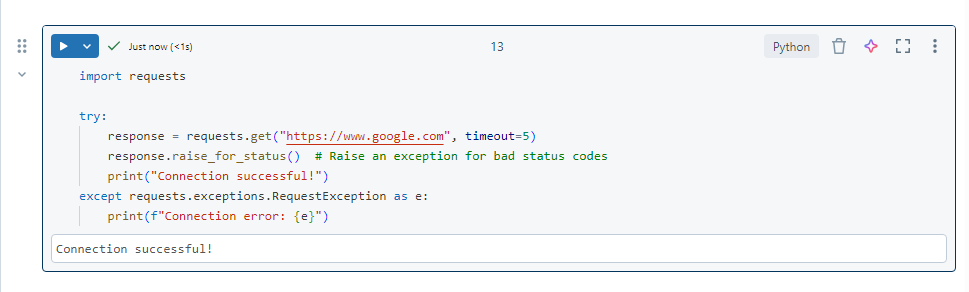

    Validate Outbound Connectivity from your Databricks cluster
    Use this sample to check outbound access and DNS resolution:
    import requests
    try:
    response = requests.get("https://www.google.com", timeout=5)
    response.raise_for_status() # Raise an exception for bad status codes
    print("Connection successful!")
    except requests.exceptions.RequestException as e:
    print(f"Connection error: {e}")
    Kindly provide your feedback !
