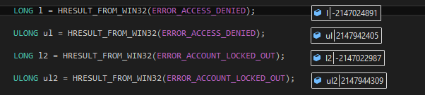

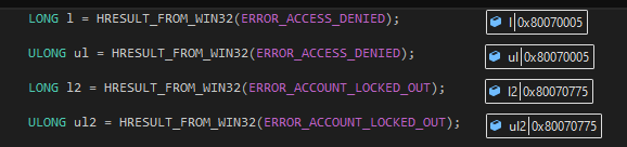

  2. Karlie Weng 19,251 Reputation points Microsoft External Staff
    Sep 4, 2024, 7:59 AM
    Hello,
    The error code 2147944309 (0x80070005 in hexadecimal) typically signifies an "Access is denied" message in Windows.
    Ensure you have the necessary permissions in the task scheduler settings.
    Additionally, verify the User Account Control (UAC) settings; you may disable it temporarily to test again.
    For more information, refer to the task scheduler log or the event log.
