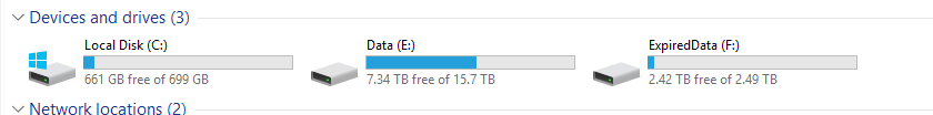

    I think we have done all of the above as you mentioned. Here are some screenshots of the disks and how they look in terms of space:
    Just to recap:
    E: = Data being backed up by MARS
    F: = MARS Scratch/cache folder relocated

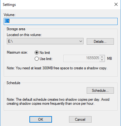

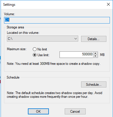

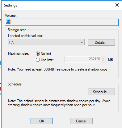

    Below is Shadow Copies configs for each drive:

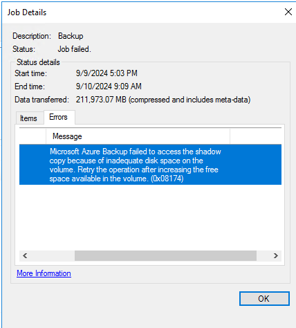

    I have also tried to select subfolders gradually to see where the error starts and looks like around the 4TB mark. If I go over that value, then MARS starts failing with the not enough space allocated.
