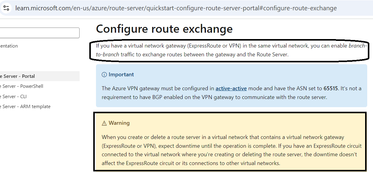

I am setting up new Route server in Vnet where Gateway subnet is already exist.As per MS steps, I am going to do peering among NVA and Route server. What to do with Gateway subnet when we deploy Azure route server.
Do we require to peer Gateway subnet with Route server OR Under route server configuration, enable " AllowBranchToBranchTraffic" only

    There is no need to peer the Gateway subnet with the Route Server. The AllowBranchToBranchTraffic setting under the Route Server configuration and appropriate BGP peering should suffice for handling the routing within the VNet. You'll need to configure BGP peering between the NVA and the Route Server.
    See: https://learn.microsoft.com/en-us/azure/route-server/peer-route-server-with-virtual-appliance?source=recommendations
