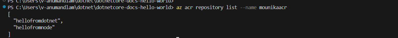

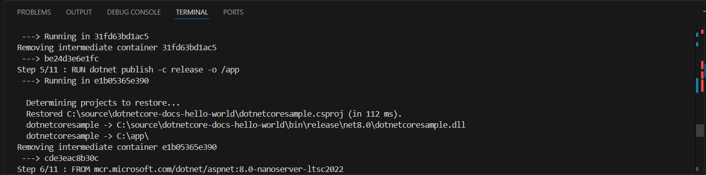

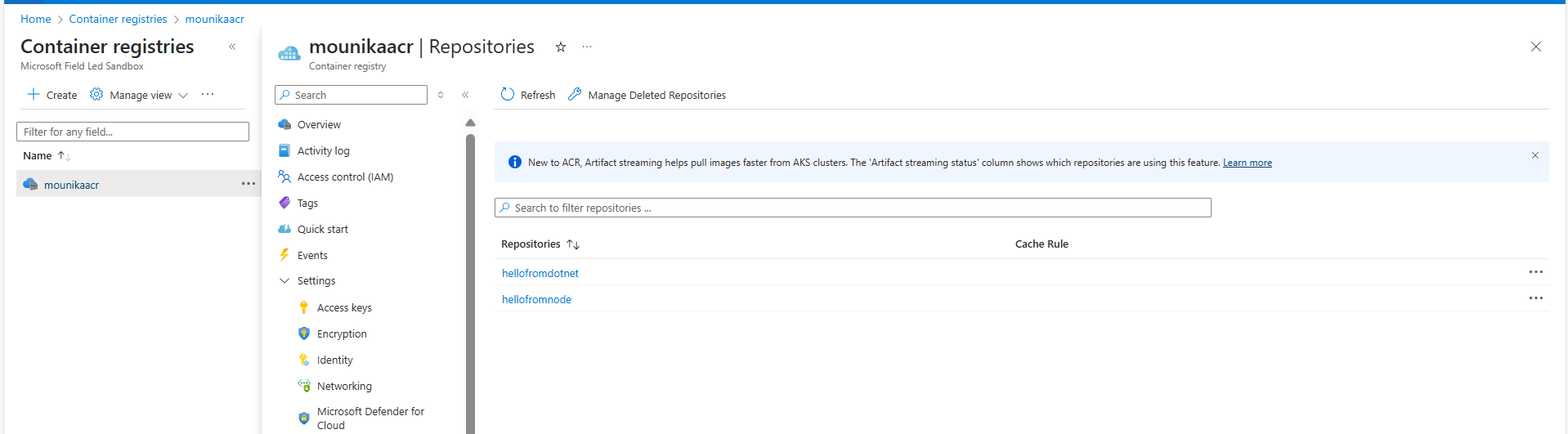

    I have Built a Linux and Windows container images and stored them in Azure Container Registry following the link https://microsoftlearning.github.io/deploy-and-manage-containers-with-azure-kubernetes-service/Instructions/Labs/Exercise_02_build_linux_windows_container_images.html and worked fine.
    I was able to deploy windows container through AzCLI using VSCode terminal using the same Dockerfile.User's image
