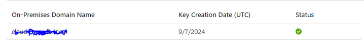

I am trying to setup Microsoft Entra ID Connect and I am receiving an error:
"An error ocurred executing Configuration ADD Sync task: An error occurred while sending the request."
As a result, I can see that my internal domain was added at Entra ID:
User's image An user was created:
But as you can see in the first screenshot, the sync is failing.
Environment:
AD: Windows 2019
Note: I have already reinstalled the "Azure AD Connect" app and tried the customized and also express option, but I am always getting the same error.
How can I resolve this issue?

  1. Abiola Akinbade 30,375 Reputation points Volunteer Moderator
    2024-09-07T20:06:26.01+00:00
    Thanks for your question.
    This is likely as a result of TLS 1.2 not being selected and used by Connect. Run the script below to enforce this:
    https://learn.microsoft.com/en-us/entra/identity/hybrid/connect/reference-connect-tls-enforcement#powershell-script-to-enable-tls-12
    The above should fix the issue.
    A lesser possibility is if you have a proxy. In that case see: https://learn.microsoft.com/en-us/entra/identity/hybrid/connect/tshoot-connect-connectivity#connectivity-issues-in-the-installation-wizard
    You can mark it 'Accept Answer' and 'Upvote' if this helped you
