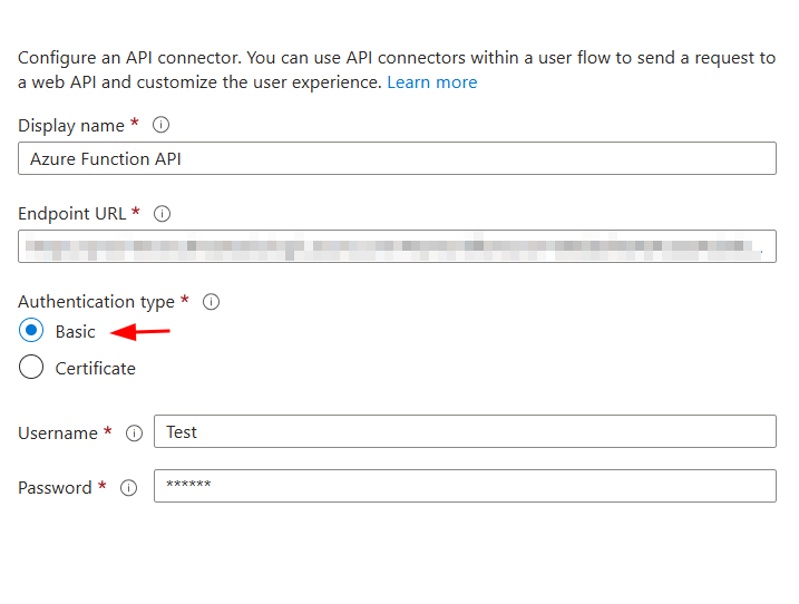

I want to add an API connector in my SignIn & SignUp user flow.

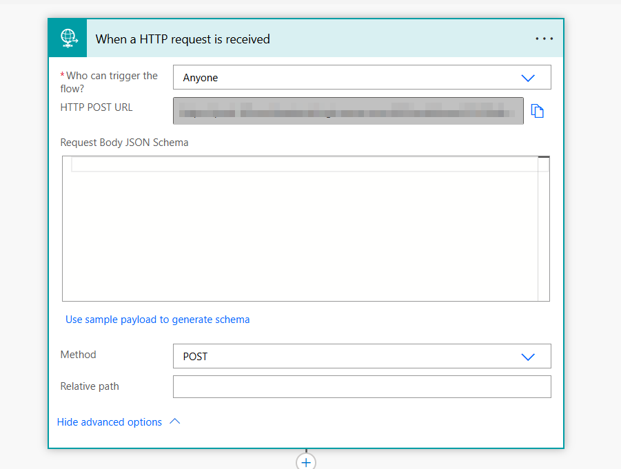

I have created a HTTP-triggered Power Automate. But unfortunately, B2C is unable to call that flow.
It is showing the below message in the logs -
{"errorMessage":"There was a problem processing your request. Please try again.","httpStatus":"401","numberOfAttempts":1}

    Hi @Power Coder , the 401 shows that this is due to authentication. Can you please check the following for me?
    • Verify that the authentication type configured for your API connector matches the authentication method used by your Power Automate flow. If your flow requires a specific authentication token, make sure it is correctly configured in the API connector settings.
    • Make sure that the endpoint URL for your Power Automate flow is correctly specified in the API connector configuration. Any discrepancies in the URL can lead to connection failures.
    • Check the permissions and access rights for the Power Automate flow. Ensure that the flow has the necessary permissions to be called by the Azure AD B2C API connector.
    Please let me know your results and I can help you further!

    The problem I found is that the Power Automate flow uses a token or signature for authentication (see extra parameters in the flow URL).
    However, the B2C connector tries to authenticate with the Basic Auth method.
    And the flow returns the status 401 Unauthorized.
    Try calling the flow using Postman and add the Basic Auth method with any username and password. It will return the following error.
        "error": {
            "code": "DirectApiRequestHasMoreThanOneAuthorization",
            "message": "The request has SAS authentication scheme, 'Basic' authorization scheme or internal token scheme. Only one scheme should be used."
