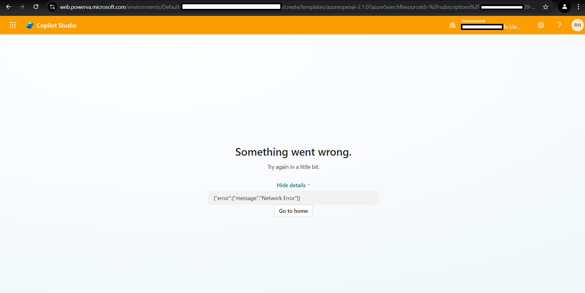

I'm unable to deploy a chatbot from Azure OpenAI Studio to Copilot Studio due to NetworkError (see screenshot at the bottom).
Four days ago I have successfully deployed and published. I haven't tried deploying after that, until today. Even after several browser reloads, re-logins, and using incognito window, the same error persists.
Has anyone encountered the same and resolved it?

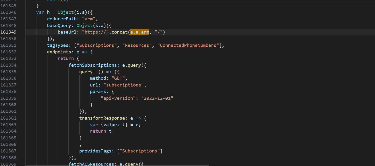

2024-09-24T13:12:20.4333333+00:00 Using the new look Azure Open AI Studio portal, I have today the same problem in Australia East region. They clearly have some coding issues - check out the URL in the picture.
Using the old look Azure Open AI Studio portal, I can deploy to Copilot Studio but I cannot make the Copilot work, it always responds that it cannot find the information in the supplied data - yet the original Azure Open AI Assistant does work ...
It seems to me that the problem is that the URL is incorrect and cannot be resolved by the DNS, hence the "network error".
In fact, I believe that there is a typo in the code in the file main.30d08dd4.js at the line where a.a.arm is used
when it should probably be g.a.arm like here
Please investigate and fix. Also, probably testing procedures also need review. Thanks
Ioan Gageanu 0 Reputation points
2024-09-24T14:49:33.6466667+00:00 I suspect that the "network error" is indeed caused by the use of the incorrect URL which cannot be resolved by DNS - see pic in earlier post.
It seems to me that the cause is
a typo in the main.30d08dd4.js in the line where it uses a.a.arm
baseQuery: Object(s.a)({ baseUrl: "https://".concat(a.a.arm, "/") })

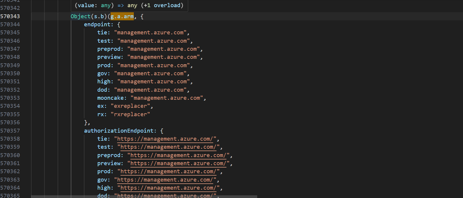

when instead it should likely be using g.a.arm as used in
Object(s.b)(g.a.arm, { endpoint: { tie: "management.azure.com", test: "management.azure.com", preprod: "management.azure.com", preview: "management.azure.com", prod: "management.azure.com", gov: "management.azure.com", high: "management.azure.com", dod: "management.azure.com", mooncake: "management.azure.com", ex: "exreplacer", rx: "rxreplacer" }, authorizationEndpoint: { tie: "https://management.azure.com/", test: "https://management.azure.com/", preprod: "https://management.azure.com/", preview: "https://management.azure.com/", prod: "https://management.azure.com/", gov: "https://management.azure.com/", high: "https://management.azure.com/", dod: "https://management.azure.com/", mooncake: "https://management.azure.com/", ex: "exreplacer", rx: "rxreplacer" }, headers: { "x-ms-client-session-id": Object(c.s)(), "x-ms-client-request-id": l.a }, authenticated: !0, addAuthTokenToHeader: !0, requestHandler: k, responseHandler: P })
Please investigate and fix and advise when done, thank you.
