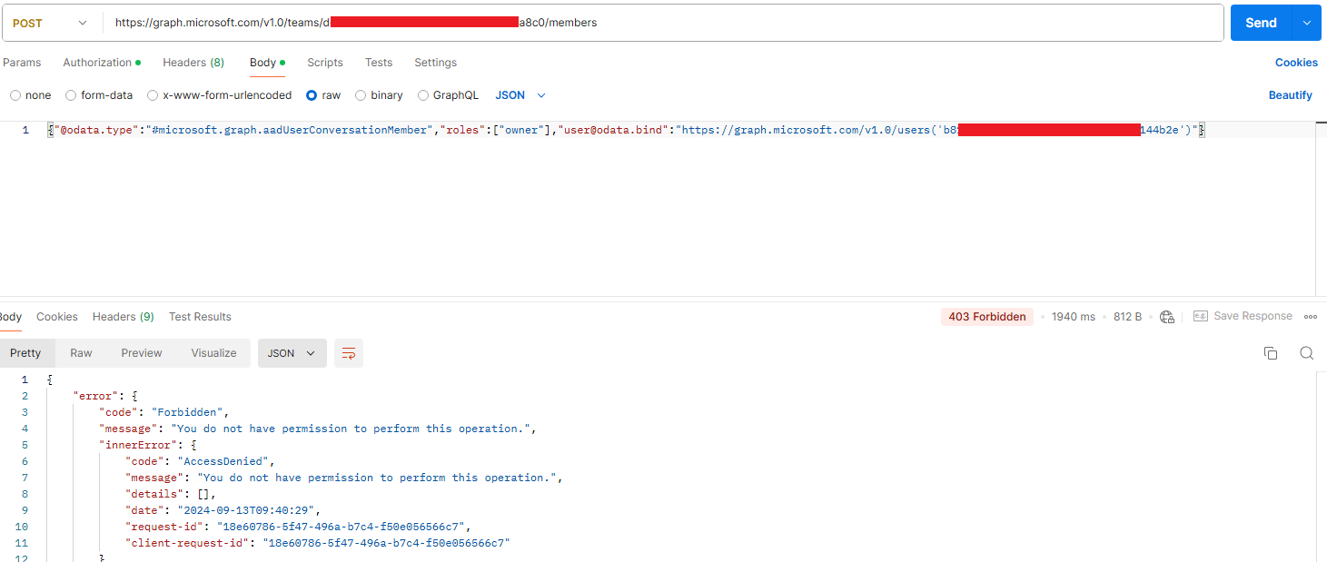

Hi guys! I have faced an issue with Team Graph API. Some times ago (approximately 3 month ago) API that adds team owner just stopped working. Here is a brief investigation. Our application is used Application type of permissions for performing API operations. For example, team creation requires “Team.Create” scope. It is granted for our application. POST that is used for Team creation:
POST https://graph.microsoft.com/v1.0/teams
Headers:
"Content-Type: application/json"
"Authorization: BEARER token"
Body: {"@microsoft.graph.teamCreationMode":"migration","******@odata.bind":"https://graph.microsoft.com/v1.0/teamsTemplates('standard')","displayName":"Restored by SpinOne for restore at Sep 06, 2024 05-43 PM","description":"for restore","createdDateTime":"2022-02-21T16:35:36.032Z"}
This query is executed successfully, team is created. But for the query that suppose to add member the same approach doesn’t work anymore. It requires “TeamMember.ReadWrite.All” scope which is present for application.
POST: https://graph.microsoft.com/v1.0/teams/{teamId}/members
Headers:
Body: {"@odata.type":"#microsoft.graph.aadUserConversationMember","roles":["owner"],"******@odata.bind":"https://graph.microsoft.com/v1.0/users('userId')"}
Response:
Response code: 403
Body:{"error":{"code":"Forbidden","message":"You do not have permission to perform this operation.","innerError": {"code":"AccessDenied","message":"You do not have permission to perform this operation.","details":[],"date":"2024-09-06T15:05:25","request-id":"b2aaa7b4-3632-4cf0-93cb-bc4e5b4337f7","client-request-id":"b2aaa7b4-3632-4cf0-93cb-bc4e5b4337f7"}}}
But all permissions are correct according to https://learn.microsoft.com/en-us/graph/api/team-post-members?view=graph-rest-1.0&tabs=http Were there any changes in API? Could you please help me with this problem?

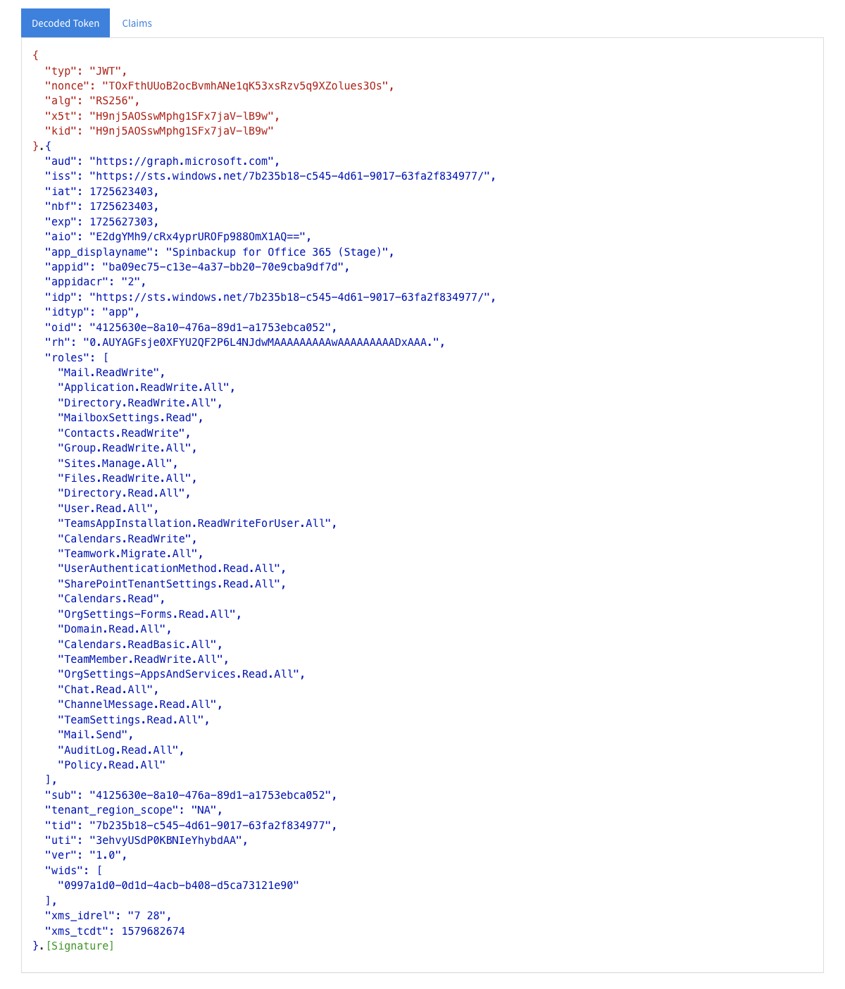

    3. Token Scope: The access token might not include the necessary scopes. Decode the JWT token (you can use tools like jwt.io) to ensure it contains the correct scopes and roles. Verify that the token includes all scopes.

  3. CarlZhao-MSFT 46,406 Reputation points
    2024-09-13T10:02:10.81+00:00
    Hi @Dmytro_dev
    After multiple tests, I was able to reproduce your issue locally.
    This is because the team you created is in a migration state, and currently, adding members to a team in this state is not supported.
    You should create a team that is not in a migration state.
    Hope this helps.
    If the reply is helpful, please click Accept Answer and kindly upvote it. If you have additional questions about this answer, please click Comment.
