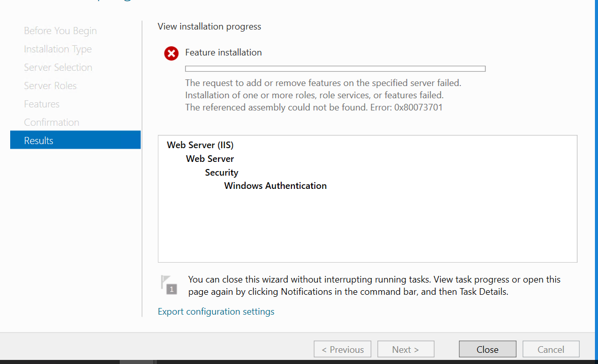

Windows Authentication under Web Server (IIS) keeps failing during installation
Kwabena 0 Reputation points
2024-09-10T14:59:54.3666667+00:00

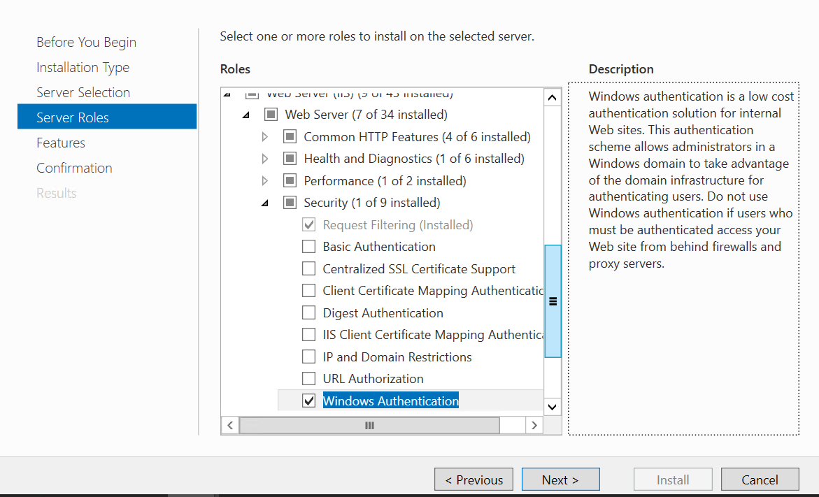

While installing Web Server (IIS) through roles and features in windows server 2019, the "windows authentication" under security seems to be failing when installing. Please see imagesAnnotation 2024-09-10 105601
Annotation 2024-09-10 105326

    The error code 0x80073701 indicates that a referenced assembly could not be found, which often points to missing or corrupted system files. Here are some steps you can take to resolve this issue:
