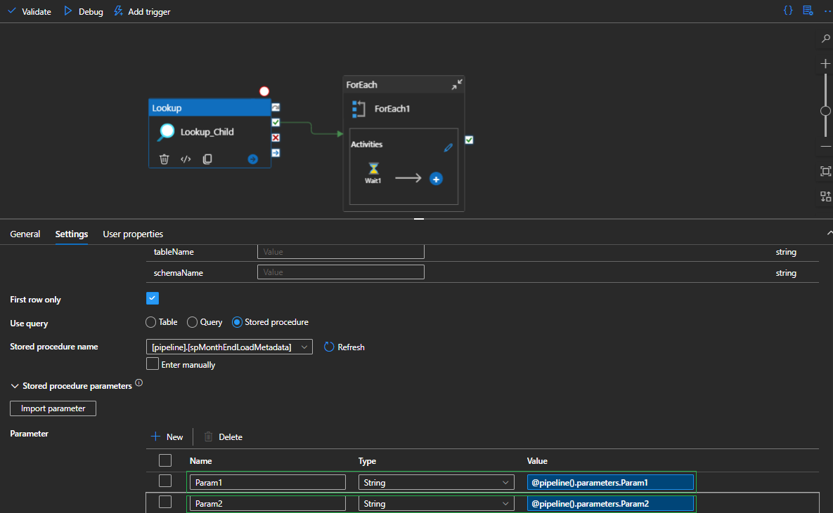

Help passing parent pipeline params to child pipeline, then use the passed params in a Lookup Activity which calls a stored procedure that takes the params as inputs.

    3. Use Parameters in Child Pipeline's Lookup Activity:
    • Inside the child pipeline, add a Lookup Activity.
      • In the Settings tab, configure the Lookup Activity to use a stored procedure.
      • In the stored procedure settings, map the parameters to the stored procedure's inputs.
      Example: If your stored procedure takes two input parameters (@input1, @input2), you can use the child pipeline parameters like this:
         "@input1": "@pipeline().parameters.param1",
         "@input2": "@pipeline().parameters.param2"

    Check 4: Verify Lookup Activity Settings
    In the child pipeline, go to the Lookup activity that calls the stored procedure. Under the Settings tab, check that the Stored procedure section is correctly configured. Make sure that the parameter names and values are correct, and that they match the parameter names defined in the stored procedure.
