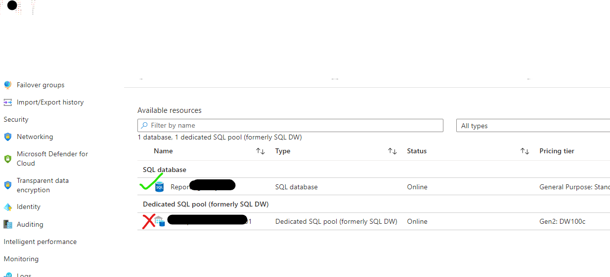

I have an Azure SQL Server with a dedicated SQL Pool (probably prior to 2020) and a reporting database. I am trying to run elastic job agent using User Managed Identities (UMI) on all database in this Azure SQL Server. I have set up all the logins, users, permission on both the job database and target server/databases (Azure SQL Server/dedicated SQL Pool/reporting database) as per Microsoft documentation. When I run the elastic job, it runs just fine in reporting database, but it fails on the dedicated SQL Pool due saying, " Failed to connect to the target database: Login failed for user '<token-identified principal>;.error <token-identify-problem). I can't seem to figure out why. is UMI even compatible Elastic Job dedicates SQL Pool?
