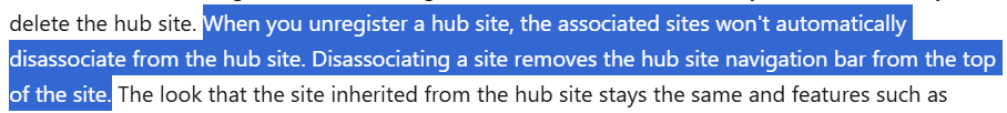

    In this article: Unregister a site as a hub site,
    This means that the old navigation bar in your site should be deleted as normal. It is very likely that your problem happened by chance. Therefore, I suggest you try the following:

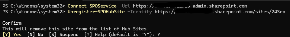

    4.Contact your SharePoint administrator to download SharePoint Online Management PowerShell, and then use the PowerShell command to unregister the site as a hub site. Please replace your site name and tenant name.
    Connect-SPOService -Url https://contoso-admin.sharepoint.com
    Unregister-SPOHubSite -Identity https://contoso.sharepoint.com/sites/Marketing

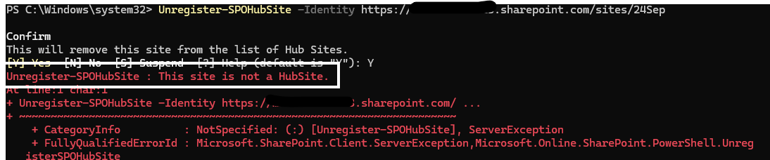

    If it is successful, it will be like this:
    If it is wrong, it will report an error, so that we can also check whether the original site has been successfully unregistered as the hub site.
