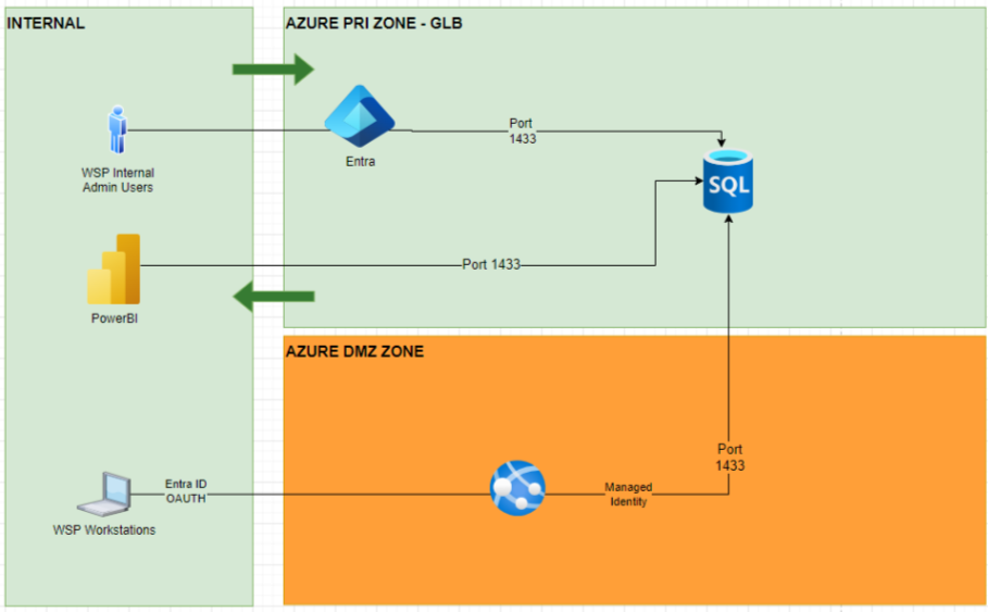

Hi ,
We were able to retrieve the access token, but when I attempted to open the SQL connection, I encountered the following error:
Microsoft.Data.SqlClient.SqlException: **'Login failed for user '
