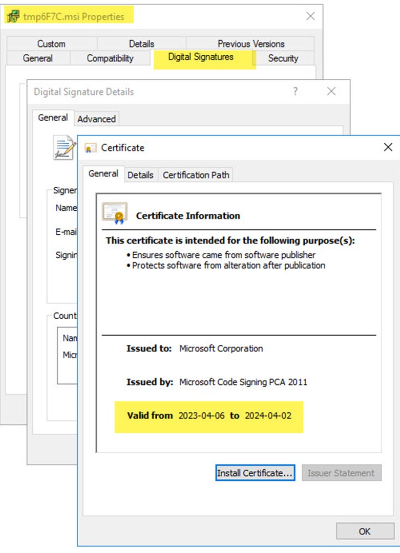

  3. Ibrahim Benna 0 Reputation points
    2024-10-01T16:14:53.5666667+00:00
    I have been doing some research on this issue and came across this. I was not able to find the first certificate in the error ID 32005 anywhere on the server. I then checked the properties of the installer file downloaded by the updater in c:\windows\Temp and found it has a code signing certificate associated with it - BUT ITS EXPIRED since April 2024!
    Unfortunately, it seems that it has to be a manual upgrade until Microsoft resolves the certificate issue
    AAD
