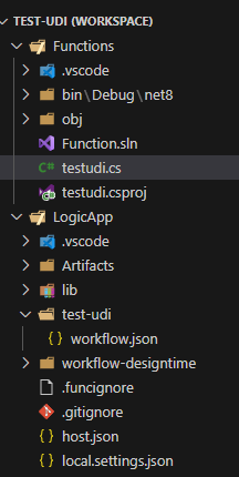

I have created custom code with logic app workspace
when I am trying to open the workflow in designer mode I am getting below error
I have tried re installing Azure function core tools and validated the dependencies it shows.
here is my structure of project and error
