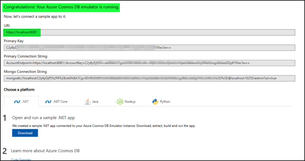

    First make sure that your Cosmos DB Emulator is running.
    1. It should be run inhttps://localhost:8081/_explorer/index.html in your browser. User's image

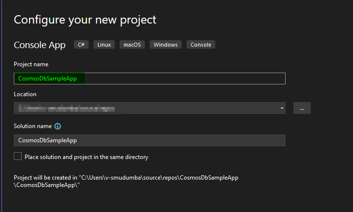

      1. Create a .NET Console Application using Visual Studio.
      "Create a new project" and select "Console App" from the list. Click "Next," name your project (e.g., CosmosDbSampleApp), and click "Create."

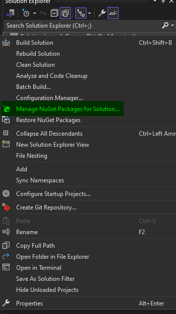

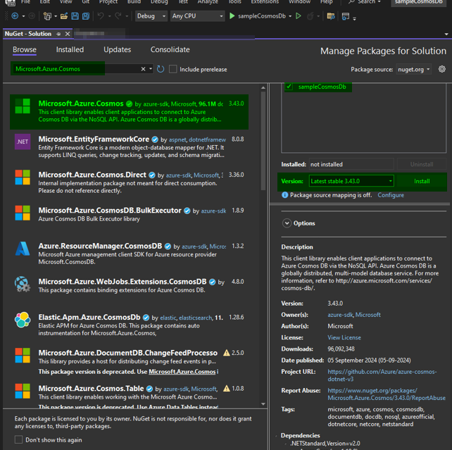

    1. Install the Azure Cosmos DB SDK.
    Open the NuGet Package Manager (right-click on the project in Solution Explorer, then select "Manage NuGet Packages"). Search for Microsoft.Azure.Cosmos and install it.

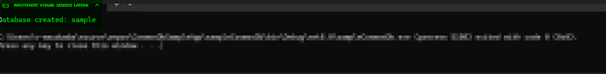

    Paste your code in program.cs and click on "start" button to build and run your application.
    You will not find any issues and the database is created.

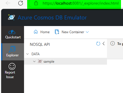

    Now, Open the Cosmos DB Emulator and you can find the Data Base there.

    Step1: Ensure the emulator is running by visiting https://localhost:8081/_explorer/index.html in your browser.

    Step3: Ensure that Microsoft.Azure.Cosmos is up to date.
