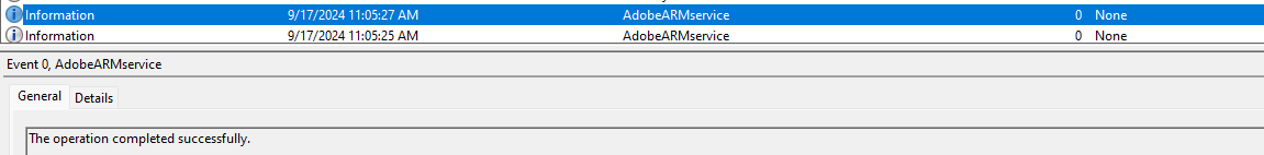

    You "may" be able to see when a service is restarted, started, or stopped for third-party software. I can see when I restarted Adobe Acrobat Update Service and a local agent in the Application logs, Event ID = 0. Unfortunately, a third attempt at restarted another local agent service failed to show here.
    Screenshot 2024-09-17 115600

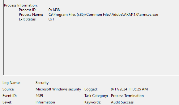

    As for seeing when a Service stops, in the Security events, look for Event ID 4689.
    Screenshot 2024-09-17 120200
