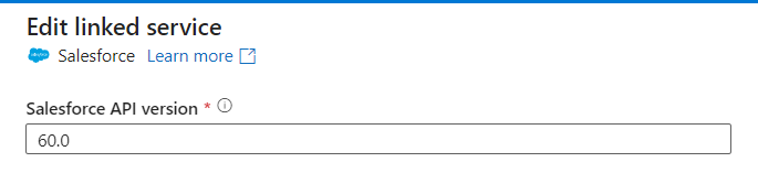

My Salesforce linked service API version is configured as below,
Does this indicate it is using the Bulk API? If not, where can i provide the apiVersion property and what needs to be given to that? Also, you have mentioned that, in copy activity, we need to ensure that the source settings are optimized for bulk data retrieval. May i know how to check on this?
phemanth • 15,760 Reputation points • Microsoft External Staff • Moderator
2024-09-20T11:48:15.0233333+00:00 The 15 GB data size limit for a bulk query in Salesforce is per query, not per 24-hour period. This means each bulk query can retrieve up to 15 GB of data, divided into 15 files of 1 GB each.
Regarding your Salesforce linked service configuration, the API version set to “60.0” does not necessarily indicate that the Bulk API is being used. The Bulk API is a specific feature that needs to be enabled in the settings.

2024-09-23T17:09:37.05+00:00 I am still facing the issue and looking for more help on this. My Salesforce linked service json has the below condition already.
"apiVersion": "60.0"

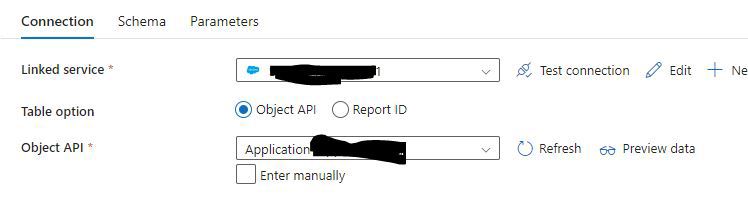

First I confirmed our Salesforce API Version with the SF Admin
Then I changed the Data set so it was looking at a specific table

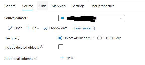

Then I changed the pipeline source so it is using the object api and the not the SOQL query that I used originally.
As stated - this at least got the preview data working but has not yet completed when I run the pipeline in debug mode.
