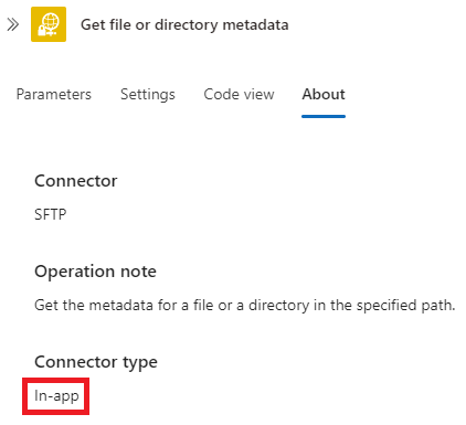

We have migrated our logic app to standard with VNet connectivity. For SFTP connector, I was expecting that the outbound connection will be from the VNet, not from the outbound IP connector list. Can someone confirm ?

    Please confirm:
    • you are using the In-app SFTP connector
    • Settings -- Network -- Virtual network integration -- under Application routing you have Outbound internet traffic selected
    • Settings -- Network -- Virtual network integration -- under Virtual network routing you have your NAT gateway selected
    qna logic app sftp in-app
    The In-app SFTP connector runs in the single-tenant environment (yours) whereas the shared/managed SFTP connector runs in the multi-tenant environment.
    With the above configuration the public IP of your NAT gateway should be used when connecting to the SFTP server.

    When you migrate your consumption logic app to standard logic app and if you have migrated to SFTP built in connector as well then logic app build in connector run in the same cluster and runtime as your Standard logic app. In this case outbound connection will be from the VNet.
    In case if you are still using the Azure SFTP connector then the call will be from outbound IP connector list. For more details on the compassion of Azure and in build connector you can refer to this document.
