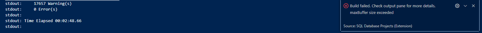

Stuck with this issue for longer time.
I am trying to create SQL Server Projects for a DB being in SQLServer2022 using VS2019 Professional.
DB is old running/being in use since 2009.
How much ever I try I face the following warnings & errors, but of huge numbers
Build warning SQL71562: SqlProcedure: --- has an unresolved reference to object---
Build warning SQL71502: SqlProcedure: --- has an unresolved reference to object---
Build error SQL71501: SqlUser: [] has an unresolved reference to SqlLogin [].
Upon searching on google, I am unable to find any solution that would fix this issue.
Also, there isn't any proper documentation in MS (as far as I searched) where we could get proper explanation/guidance to reach out the solution.
1 thing to add, I am trying from both VS2019 and AzureDataStudio. But no luck from both.
But the AdventureWorks DB - I am able to create projects as well as able to build without any errors/issues.
Possible to help?
