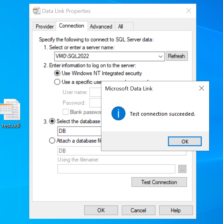

    Could you successfully connect to your SQL server instance using local SSMS?
    Please follow below steps to troubleshot SQL server connection issue,
    1. Make sure SQL Server Service is running, you can check this from SQL server configuration manager or windows service.
    2. If a named instance, make sure SQL Server browser service is running. Make sure the instance name is spelled correct and there is actually such an instance on your target machine.
    3. Make sure SQL Server is configured to allow remote connections if this is a remote connection.
    4. Examine the SQL Server error log for messages confirming that SQL is listening on the expected network interfaces and ports.
    5. Test server connectivity with PING from the client machine.
    6. Test port connectivity using TELNET to the server and port (from step 4) from the client machine.  For example,
    TELNET <server-name> 1433
    1. Check firewall settings if step 5 or 6 connectivity test fails.
    If you have some confuse about the steps, please refer to MS document A network-related or instance-specific error occurred while establishing a connection to SQL Server to get more information.
