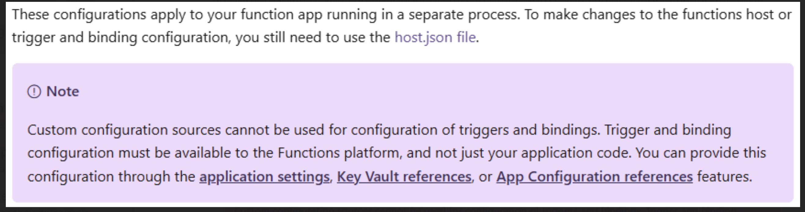

    @Sayed Reda Thanks for reaching out. In the isolated worker model, you can’t change the host configuration in code because your function runs in a separate process from the host. Instead, you need to configure settings like maxBatchSize and prefetchCount in the host.json file.
    https://learn.microsoft.com/en-us/azure/azure-functions/functions-bindings-event-hubs?tabs=isolated-process%2Cextensionv5&pivots=programming-language-csharp#hostjson-settings
    This is mentioned here please refer: https://learn.microsoft.com/en-us/azure/azure-functions/dotnet-isolated-process-guide?tabs=linux#configuration
