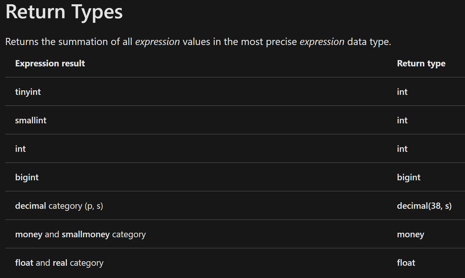

  3. David Browne - msft 3,851 Reputation points
    2020-12-22T17:09:25.413+00:00
    You should cast the result to the target type, but only if you're certian that aggregate won't overflow its return type.
    https://learn.microsoft.com/en-us/sql/t-sql/functions/sum-transact-sql?view=sql-server-ver15#return-types
  4. Erland Sommarskog 121.4K Reputation points MVP Volunteer Moderator
    2020-12-22T22:49:01.163+00:00
    It seems reasonable to assume that it will, since else why do we want 16 digits before the decimal point?
    Given Tom's post, the best is maybe
    cast(sum( cast(a as decimal(18,2)) decimal(18,2)
    Just so that Ahmed talks about, if you sum integer values, the result cannot exceed 2.147 milliards, since that is the upper limit of an int. Therefore you need to convert inside the sum to avoid that problem.
