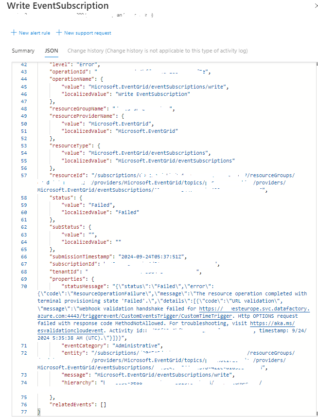

  1. TOMA 0 Reputation points
    2024-09-24T10:01:10.8966667+00:00

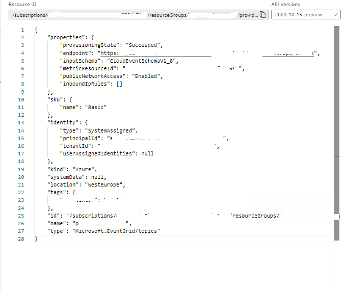

    Thanks for the answers, however, I followed what you described, as I created an event grid custom topic, where I set the input schema to CloudEventSchemaV1_0.
    eventgrid1
    I checked if the subscription is registered with resource provider.
    eventgrid2 eventgrid3 eventgrid4
    I created a custom trigger as below, selecting the appropriate event grid,eventgrid6
    However, when trying to activate this trigger I get this message in Synapse
    and in Event grid, I came across this error message
    eventgrid5
    The test message I send looks like the following, I get no error when sending.
        "specversion" : "1.0",
        "type" : "com.example.someevent",
        "source" : "/mycontext",
        "id" : "C234-1234-1234",
        "time" : "2018-04-05T17:31:00Z",
        "comexampleextension1" : "value",
        "comexampleothervalue" : 5,
        "datacontenttype" : "application/json",
        "data" : {
            "appinfoA" : "abc",
            "appinfoB" : 123,
            "appinfoC" : true
