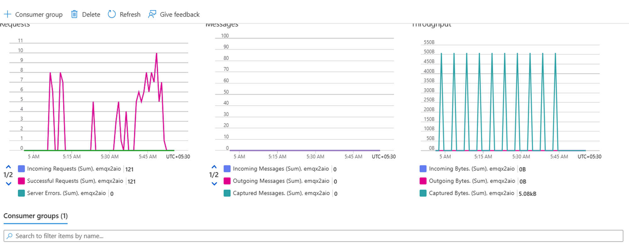

Hello,
We have an Event Hub namespace set up but we can see successful/incoming requests without any messages or throughput. Why is this happening?

    Regarding the 'ghost' messages, I checked it myself when I created a new Event Hub.
    I too experienced new messages:
    WhatsApp Image 2024-09-26 at 12.21.09_14b1a3a8
    The Event Hub has a built-in way to see queued messages, look for "Process data" in the menu:
    WhatsApp Image 2024-09-26 at 12.21.39_d871160f
    Be aware a consumer group is created for this viewer. A 'basic' Event Hub only support the creatino of one consumer group:
    WhatsApp Image 2024-09-26 at 12.22.02_61030dba
    A StreamAnalytics-like dashboard is show, normally showing ingested data.
    But you probably get a messagebox like this:
    WhatsApp Image 2024-09-26 at 12.22.26_128e2228
    I expect these messages are used to test the connection (also seen when an Stream Analytics Job output is created and you hit the Test button). These messages are then filtered out.
