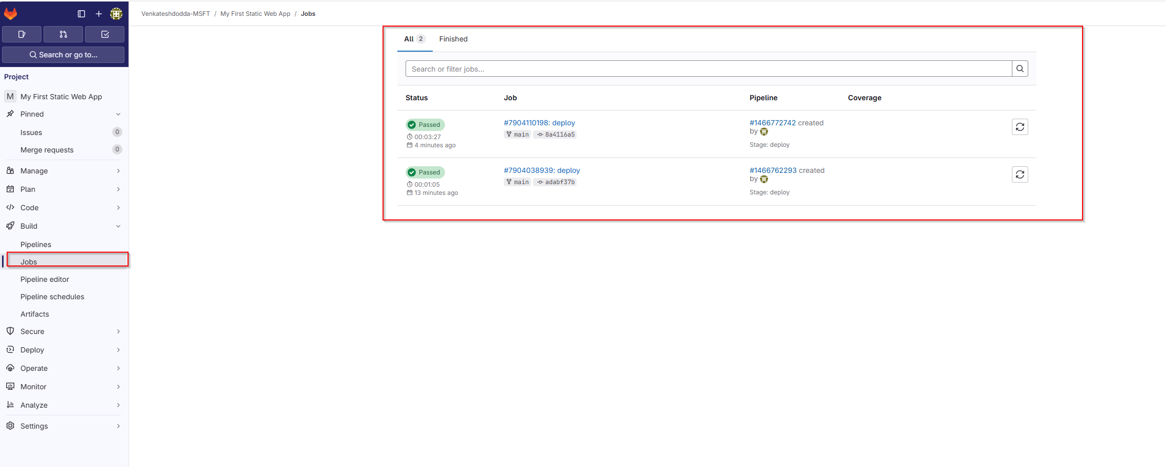

    You can monitor whether the deployment has been triggered to static webapp or not using the Jobs --> under Build --> under your GitLab Repo as shown below.

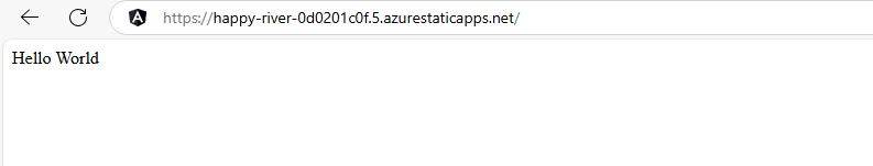

    Post committing the above change to Repo this will trigger a deployment job to static webapp (you monitor the job by following the above) Once the job is done when you request the url of the App service you will be able to see the below.
