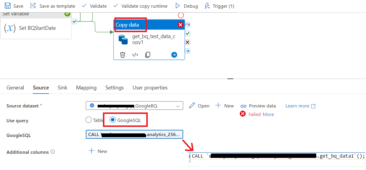

I want to invoke the BigQuery routine from Azure Data Factory. I use “Copy data” to invoke BQ Routine from Data Factory. Using the old Big Query Linked Service (Legacy) the below invocation of BQ Routine from ADF works without errors.
@concat('
    CALL mycompany-gcp.analytics_266606666.get_appointment_report(
            variables('BQStartDate'),
            variables('BQEndDate'),

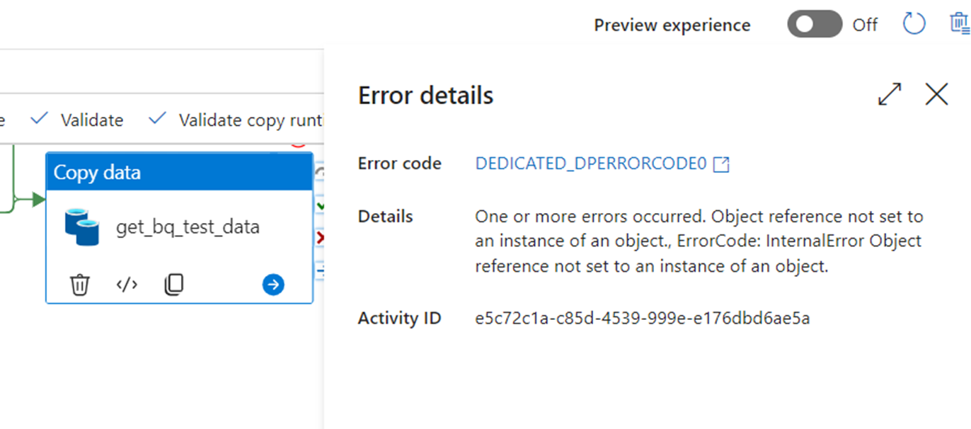

But, when I use the new Big Query Linked Service, the routine fails with below error code. The old and the new Big Query Linked service configuration are the same.

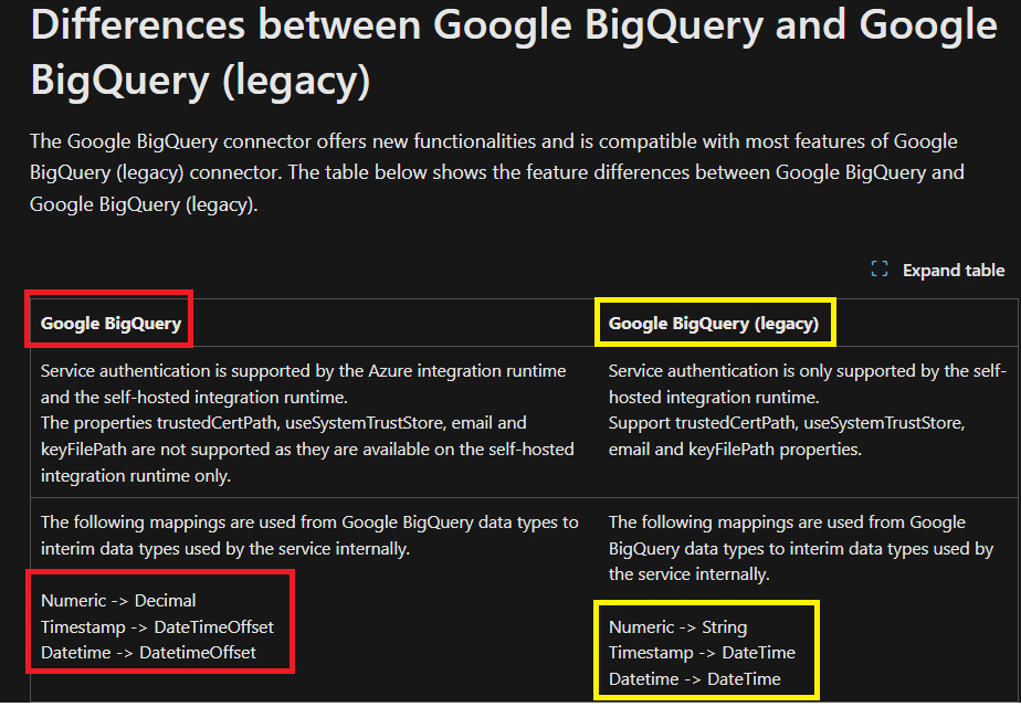

I have gone through the ADF documentation where there is a comparison between legacy and new connector.
https://learn.microsoft.com/en-us/azure/data-factory/connector-google-bigquery?tabs=data-factory

    Ensure that the parameters passed from Azure Data Factory (ADF) to BigQuery are correctly formatted for the new service. The new connector might require a different way of escaping or quoting parameters. For example, ensure that the single quotes are correctly formatted and variables are passed in the expected way.
    Temporarily replace variables('BQStartDate') and variables('BQEndDate') with hardcoded values to check if the issue persists. This can help determine if the issue lies in how ADF is resolving the variables or how they are passed to BigQuery.
     '2023-09-01', '2023-09-30'
    The new connector might have updated rules for handling stored procedures and routines. Double-check the Microsoft Documentation on the new BigQuery connector to see if there are changes in how routines and input parameters are managed.
