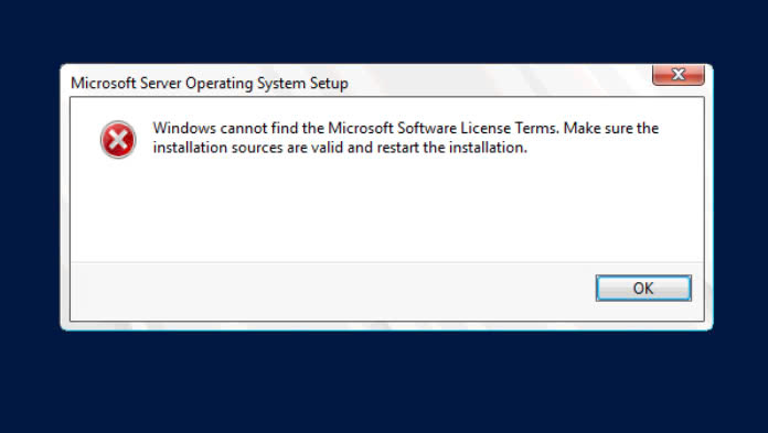

I tried to reinstall windows server 2022 standard after once installed on server HPE DL380 Gen10 plus. I used the Intelligent Provisioning to setup the server. After the setup procedure, it booted into the windows and the screen was showed error as the picture. I used the iso file which was downloaded from microsoft. People have any idea of the fix ?
install WS error

    Hello,
    This can happen for several reasons, such as a corrupted installation media, missing files, or issues with the server's hardware configuration. Here are some troubleshooting steps you can take:
    1. Burn ISO to USB/DVD Correctly:
      • If you're using a USB drive, ensure that it's properly formatted.
    2. Check BIOS/UEFI Settings:
      • Ensure that your BIOS/UEFI settings are configured correctly. Secure Boot should be disabled if it's causing compatibility issues, and make sure the boot order is set to boot from the USB/DVD first.
    3. Try a Different USB Port or DVD Drive:
      • Sometimes the issue could be with the port or drive itself. Try using a different USB port or an external DVD drive to rule out hardware problems.
    4. Check for Hardware Issues:
      • There may be a hardware issue with the server, such as a faulty hard drive or RAM. Run a diagnostic check on the server's hardware using diagnostic tools.
