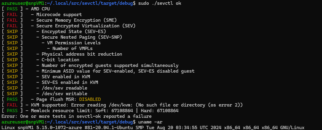

Hi~
I found that when I entered the CVM-SNP in Azure and used the sevctl (https://github.com/virtee/sevctl), which is the tool provided by AMD to detect a SNP guest status, the result seemed not normal.
So, how can I make sure that I am within a real SNP guest? I plan to use sevctl and sevtool for some experiments.

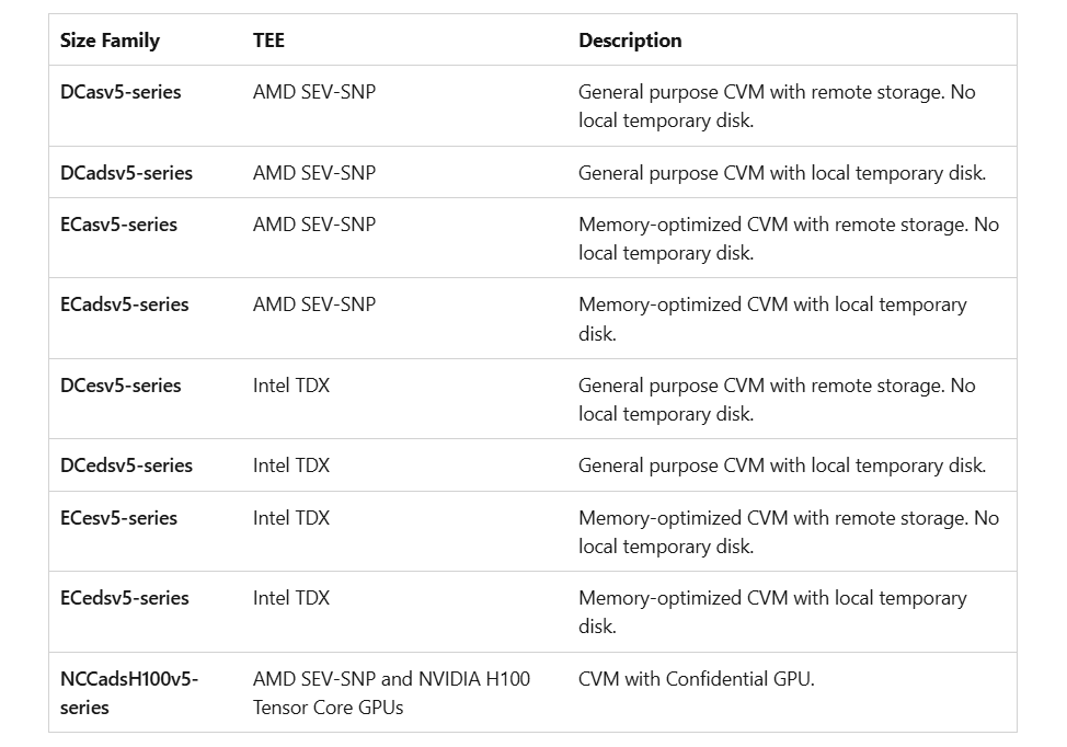

Can I launch another CVM-SNP with higher kernel version?
When I was creating the existing one, I saw the option 'Ubuntu Server 20.04 LTS (Confidential VM - SEV-SNP Only)' in the image list and chose this for this CVM.
What if I choose 'Ubuntu Pro 22.04 LTS (Confidential VM)', then which type of CVM guest will I obtain? Besides, what if I choose Ubuntu 24.04 image, of which the introduction says 'Secure virtualisation with AMD SEV-SNP and Intel TDX'? I think it is because the SNP guest-kernel support has been upstream.

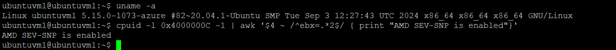

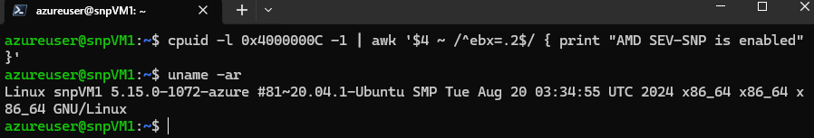

    You can suggest the customer to run below command to check the status
    cpuid -l 0x4000000C -1 | awk '$4 ~ /^ebx=.2$/ { print "AMD SEV-SNP is enabled"}'
    The -l flag specifies the leaf to query, where 0x4000000C is a leaf specific to querying AMD SEV-SNP features.
    The -1 flag means to print the result of the CPUID instruction for this specific leaf.
    ~ /^ebx=.*2$/ is a pattern matching condition that checks if ebx contains a value ending with 2. The value of ebx here could indicate SEV-SNP feature.
    In short, above command checks if AMD SEV-SNP is enabled on the system by querying the CPU features. If the condition is met, it prints the message “AMD SEV-SNP is enabled".

    Azure confidential VMs use the concept of a paravisor to implement enlightenment on behalf of the guest OS so that the guest OS can run mostly unmodified inside a CVM across various hardware providers. With the paravisor, the guest OS does not need to be fully enlightened to run confidential in Azure, meaning that we can support older OS versions on Azure confidential VMs.
    OpenHCL is an implementation of the paravisor for Confidential VMs in Azure, that will soon be available in the Azure fleet. The OpenHCL VTL2 partition is used to securely host the guest paravisor firmware layer for confidential VM support. As mentioned above, OpenHCL will effectively allow guest VMs to run as confidential VMs in Azure, adding support across a wide variety of guest OS’s and confidential hardware providers.
     Because of Azure implementation methodology of confidential VM leveraging paravisor, the tool sevctl released by AMD does not work. We also recommend customers to leverage CVM guest attestation to attest it is truly confidential VM with security feature turned on.

    Yes, you can launch Confidential Virtual Machines (CVMs) with Secure Encrypted Virtualization-Secure Nested Paging (SEV-SNP) on a higher kernel version. However, it’s important to ensure compatibility and stability.
    https://learn.microsoft.com/en-us/azure/confidential-computing/confidential-vm-faq#can-i-convert-a-dcasv5-ecasv5-cvm-into-a-dcesv5-ecesv5-cvm-or-a-dcesv5-ecesv5-cvm-into-a-dcasv5-ecasv5-cvm-
    When you create an Ubuntu Server 20.04 LTS (Confidential VM - SEV-SNP Only), you will obtain a Confidential Virtual Machine (CVM) guest that leverages SEV-SNP (Secure Encrypted Virtualization - Secure Nested Paging). This technology, provided by AMD, offers hardware-based isolation between virtual machines, the hypervisor, and host management code. It ensures that the VM's memory is encrypted and protected from unauthorized access. https://azuremarketplace.microsoft.com/en-us/marketplace/apps/canonical.0001-com-ubuntu-confidential-vm-focal?tab=Overview
    When you create an Ubuntu Pro 22.04 LTS (Confidential VM), you will obtain a Confidential Virtual Machine (CVM) guest that includes several advanced security features. These features are designed to provide strong security and confidentiality guarantees. https://azuremarketplace.microsoft.com/en-us/marketplace/apps/canonical.0001-com-ubuntu-pro-confidential-vm-jammy?tab=Overview
    For the x86 architecture, both AMD and Intel processors provide hardware features (named AMD SEV SNP and Intel TDX respectively) to support running virtual machines with memory encryption and integrity protection. They ensure that the data contained within the virtual machine is inaccessible to the hypervisor and hence the infrastructure operator.  Support for using these features as a guest virtual machine was introduced in the upstream Linux kernel version 5.19.
    https://ubuntu.com/blog/whats-new-in-security-for-ubuntu-24-04-lts
    If you have any further queries, do let us know.
