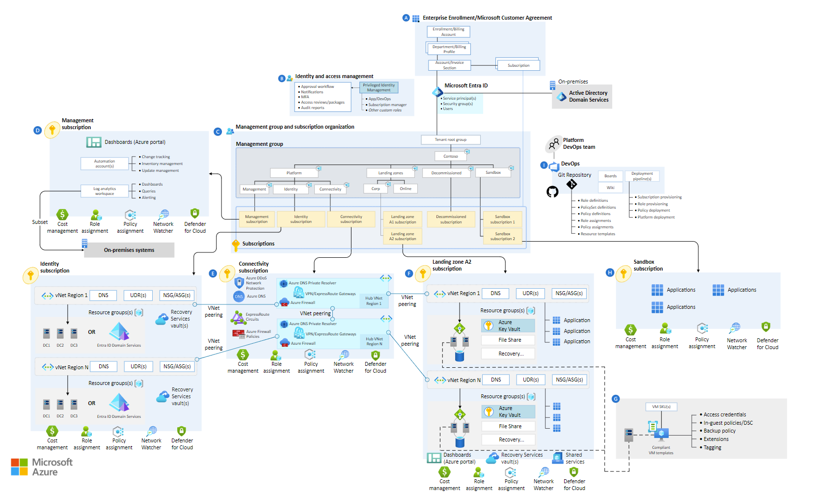

  1. Landing Zones suggest you to use few subscriptions...Ok, but Microsoft Standard and Premium Azure support is assigned by subscription...It means I should pay one support for each subscription?
  2. In realistic scenarios, companies used to have few environments such as prod, dev and test...how it fits inside this diagram ? Is one diagram like this per environment? Maybe I sould create Landing Zones A2-DEV,Landing Zones A2-PROD,Landing Zones A2-TEST and the other should be shared? Perhaps one diagram like this for Prod and other for low environments (DEV/TEST) ?

    There is no "right" or "wrong" how you structure your landing zone subscriptions.
    One of our customers is running the landing zone using different Azure subscriptions for each environment: Landing Zones A2-DEV, Landing Zones A2-PROD, Landing Zones A2-TEST
    Another customer separates PROD, DEV and TEST just by different vNets/NSG/Firwall in one Azure subscription.
    Both approaches are valid in my opinion. The design should be based on the individual requirements.
