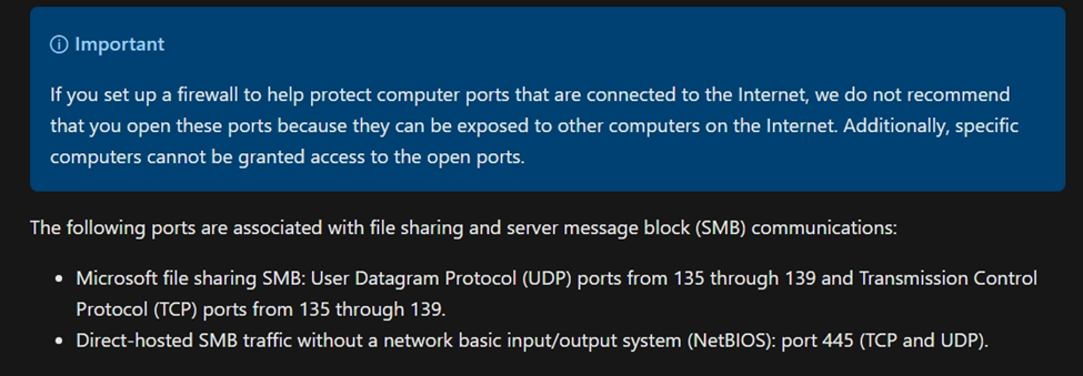

    1. Check firewall ports:
    Internet firewalls may prevent file sharing. Check the following port configurations:
    I hope this helps.
