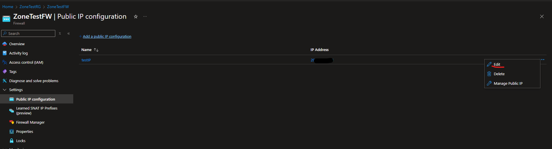

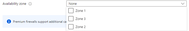

    In this scenario as the IP address is standard SKU instead of adding an additional Zone redundant IP address, you can instead edit the existing IP Address Config on your firewall and select a Zone IP address.
    Below will be the steps to achieve this.
    • First deploy a Zone Redundant IP address in the region where the firewall is deployed.
    • Then Azure Firewall->Public IP configuration page and then edit the existing IP config and select the Zone Redundant IP address you created above in drop down and save.(You can refer to my screenshots below)User's image User's image
    After this process you can follow the steps documented here to configure availability zones for your Azure Firewall.
