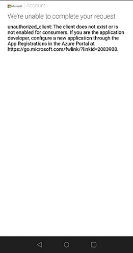

If I click on LoginButton, It navigates to the Microsoft login page, and If I try to log in with mail, it shows the below error.
We're unable to complete your request unauthorized_client: The client does not exist or is not enabled for consumers. If you are the application developer, configure a new application through the App Registrations in the Azure Portal at https://go.microsoft.com/fwlink/?linkid=2083908.
Screenshot:
ImportedPhoto_1727944061988
So, I am unable to generate the authentication token using OAuth 2.0. Is this process correct? How can I generate the authentication token to call the Google Developer API for .NET MAUI Apllication?
    This error message is usually caused by the Azure side not configuring the account authentication correctly.
    In the Q&A, some users have encountered the same error message and solved the problem by configuring Manifest.
    You could refer to unauthorized_client: The client does not exist or is not enabled for consumers for more detailed information.

    You appear to be trying to use azure to get the token, but you need to use googles oauth server.
    https://developers.google.com/identity/protocols/oauth2
