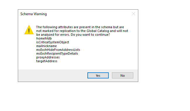

I have an on prem user with the same userPrincipalName, proxyAddress as a cloud user.
Error: Unable to update this object because the ProxyAddresses value SMTP:FFlintstone@SlateRockandGravel.com associated with this object may already be associated with another object in your local directory services. To resolve this conflict, first determine which object should be using the conflicting value. Then, update or remove the conflicting value from the other object(s).
I think the problem is Azure sync is trying to add a new user with the duplicate proxy address instead of connecting to the user already on the cloud. Is it possible soft match is disabled and if so, how can it be enabled?IDFix displays this warning and as the proxyaddresses "are not marked for replication" no errors are displayed
