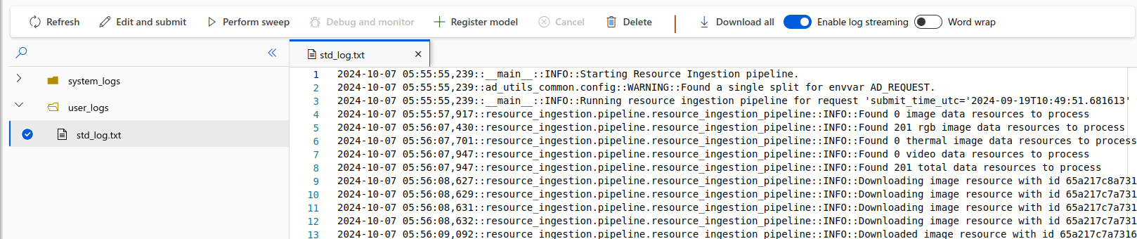

The URL in the output forwards me to the portal where I can view the job. I have two folders of logs called system_logs and user_logs .
I want the std_log.txt file in the user_logs folder to be streamed in my terminal. Temporarily, I am downloading the logs.
