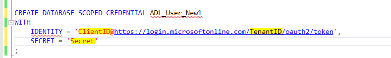

  1. HarithaMaddi-MSFT 10,151 Reputation points
    2021-01-07T15:59:38.377+00:00
    Hi @Priya Jha ,
    Thanks for sharing your valuable feedback. Product team looked into it and suggested correct syntax and would be soon publishing the correct changes to the document as well. In the OAuth 2.0 endpoint please replace "organizations" with Tenant ID and please remove "\" after @ in the identity as below which is working fine to retrieve the data from ADLS.
    Please let us know for further queries and we will be glad to assist.
