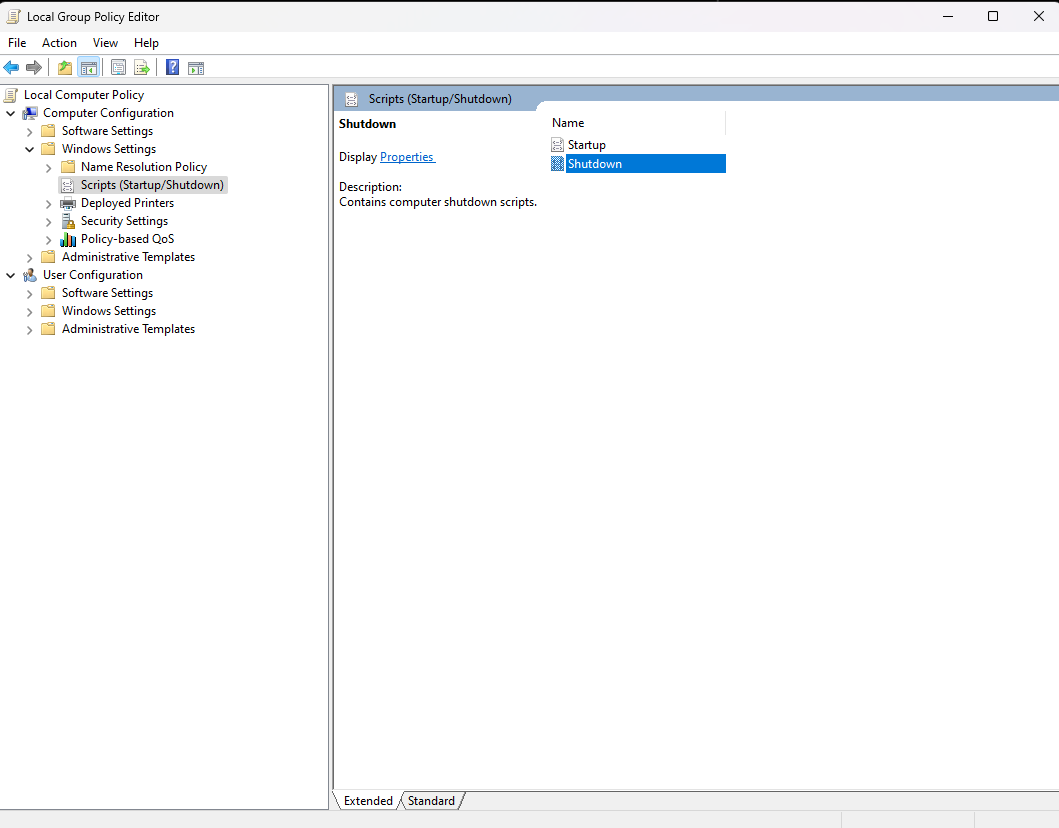

  2. Darrell Gorter 2,731 Reputation points
    2024-10-07T20:28:55.36+00:00
    Hello,
    there is a group policy for running shutdown scripts
    Try this and see if it works for
    Darrell
