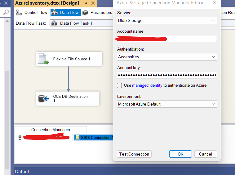

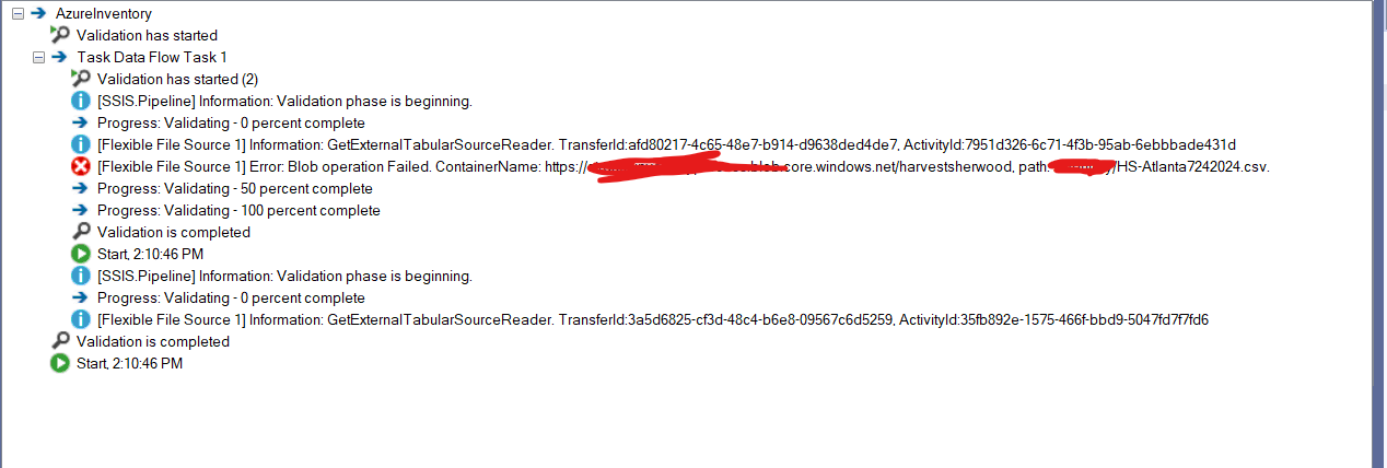

I am getting the error below when trying to load a flat file (txt and csv) in an azure blob storage . I get the error below without much details to it. I have use 2022 and 2017 versions of azure extensions but same error. When I test the connection for ssis connection manager it is successful. Any thoughts and help please
[Flexible File Source 1] Error: Blob operation Failed. ContainerName: https://XXXXXXXX.blob.core.windows.net/harvestsherwood, path: XXXXXXX/HS-Atlanta7242024.csv.
