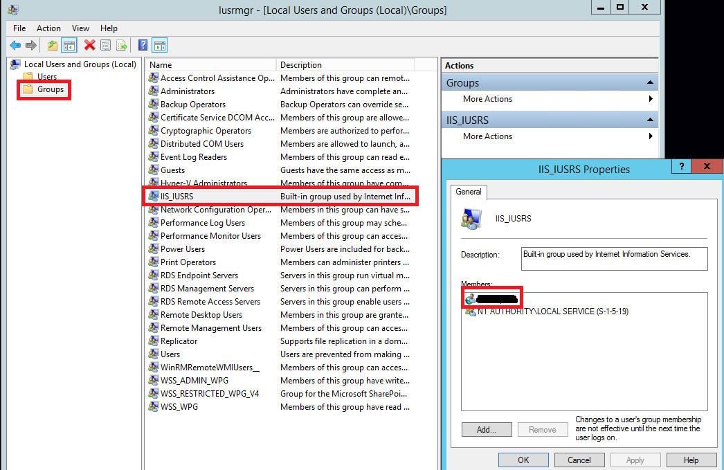

    (1)Go to IIS, check the account of the application pool in the identity column. Make sure you use correct account and password to start the application pool.
    2 (2)Go to lusrmgr.msc -> Local Users and Groups a -> IIS_IUSRS. The application pool account must be a member of this group.

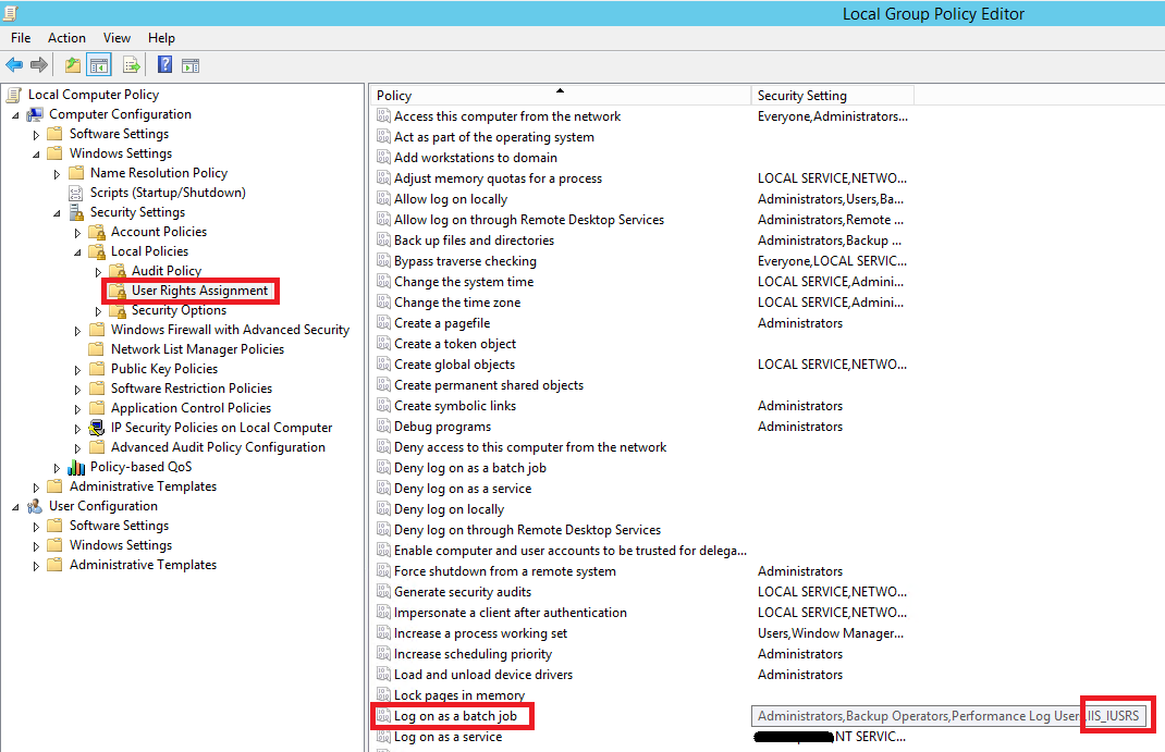

    3
    (3)Go to gpedit.msc -> Computer Configuration > Windows Settings > Security Settings > Local Policies > User Rights Assignment -> Verify that the IIS_IUSRS group is included in the following policy: "Log on as batch job" and "Impersonate client after authentication".
    4
