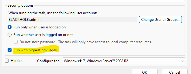

    In Task Scheduler, be sure that the task is set to run with an account that is a member of the Administrators group and in the Security section, select "Run with highest privileges".
    If you are not using the Windows Task Scheduler, then you will need to explain what "every time I run a task" means.
