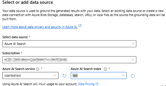

    Thank you for reaching out to Microsoft Q&A forum and glad to hear you’re working with Azure AI Search. Since I was able to connect to the Azure AI Search service successfully.
    When using an existing Azure AI Search index with Azure OpenAI, ensure that the index has at least one searchable field and set the CORS Allow Origin Type option to all and the Allowed origins option to *. This can help improve the visibility of your search service. For more info, please refer to: Supported data sources.
    Also, you can do some troubleshooting steps you can follow:
    1. Check Permissions: Ensure your Azure OpenAI instance has the necessary permissions for Azure AI Search.
    2. Recreate the Search Service: Consider deleting and recreating your Azure AI Search service in the same resource group and region.
    I've attached a screenshot of my successful connection for your reference. User's image
    If you continue to face difficulties after trying these steps, please let me know, and I'll be more than happy to assist further. I'm here to work through this with you and can walk you through further troubleshooting or investigate the issue in more detail if needed. Your success with this setup is important, and I’ll be happy to escalate the issue internally if necessary to ensure a quick resolution.
