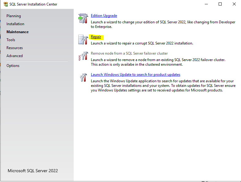

    Hi @Avirup Aditya ,
    Thank you for your reaching out and welcome to Microsoft Q&A!
    Please try to launch the SQL Server Setup program (setup.exe) as administrator:
    In addition, as far as I know, Error code: 2068119551 means Anti-Virus software is blocking deployment, you could try to Exclude the respective folders from Anti-Virus scans or disable Anti-Virus and deploy the patches.
    Finally, if you still fail to install it. It is not easy to uninstall SQL Server completely, something you failed to install last time may hinder your installation. You could reinstall it and follow the steps below:
    1. Uninstall the instance clearly follow this: cleanly-uninstalling-stubborn-sql-server-components,
    2. Reinstall the instance follow steps as this: step-by-step-installation-of-sql-server-2022
    I hope this helps! If you have any more issues or need further assistance, feel free to share with us!
